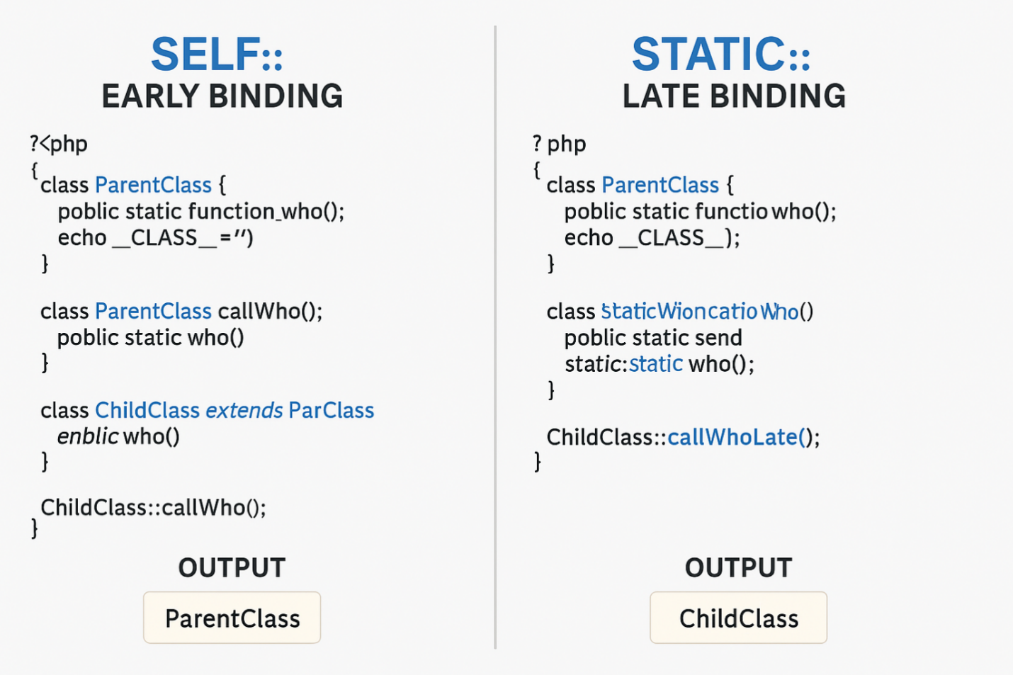

12.What is late static binding in PHP?
Late Static Binding in PHP refers to the ability to reference the called class in a context of static inheritance, rather than the class where the method is originally defined.
Why it's needed:
In regular inheritance, using self:: inside a parent class always refers to that parent class, not to the child class—even if the method was called from the child.
To overcome this, PHP introduced static:: in PHP 5.3, enabling late static binding.
class ParentClass {
    public static function who() {
        echo "Parent ".__CLASS__ . "<br/>";
    public static function callWho() {
        self::who(); // Uses early binding
    public static function callWhoLate() {
        static::who(); // Uses late static binding
class ChildClass extends ParentClass {
        echo "Child ".__CLASS__ ;
ChildClass::callWho();     // Output: Parent ParentClass
ChildClass::callWhoLate(); // Output: Child ChildClass

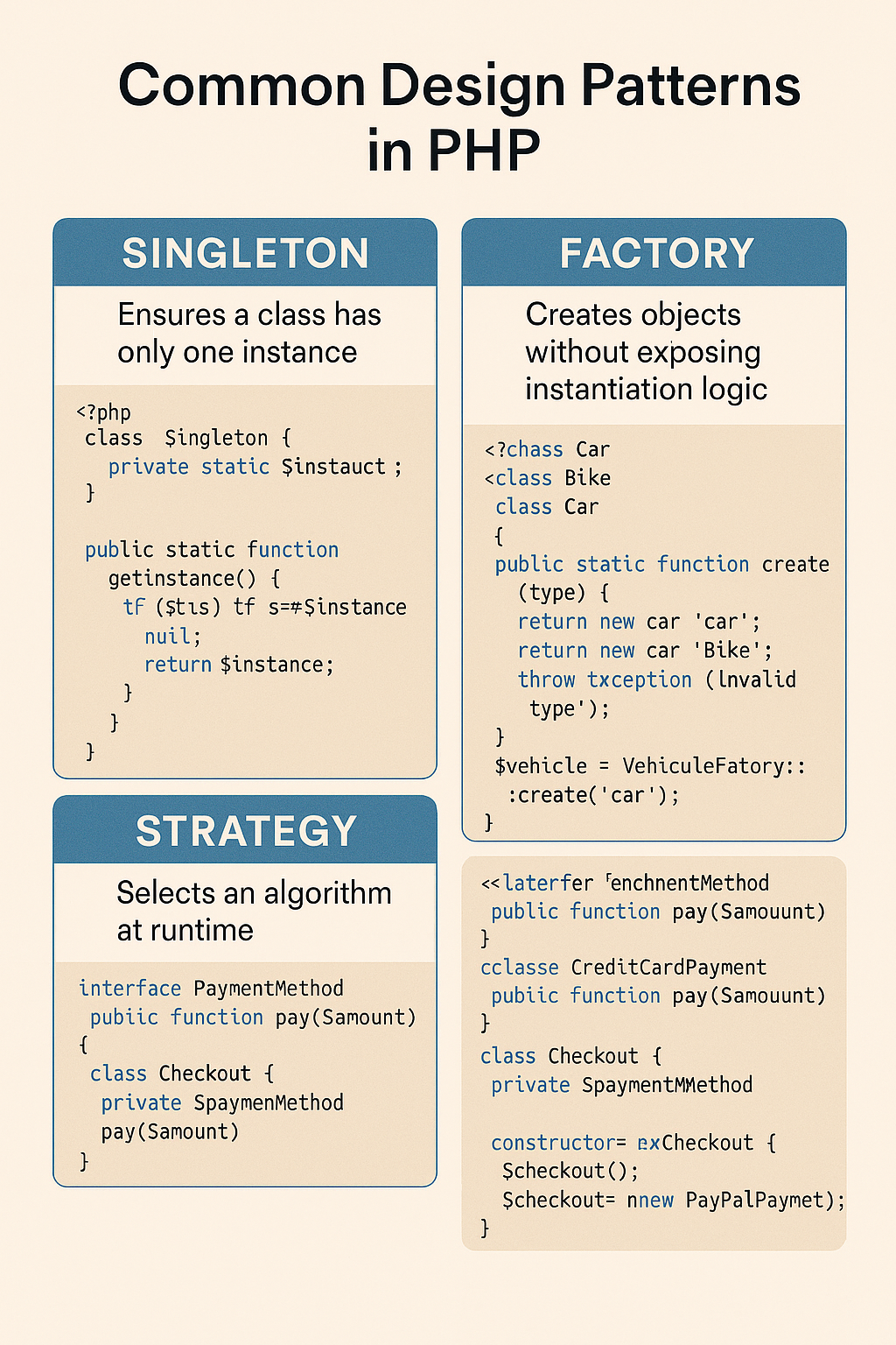

15. What are design patterns you've used (e.g., Singleton, Factory, Strategy)?
Design patterns are proven solutions to common problems in software design. As a senior PHP developer, you should be familiar with several. Here's a quick overview of some commonly used design patterns in PHP, with examples:
1. Singleton Pattern
Ensures a class has only one instance and provides a global point of access to it.
class Singleton {
    private static $instance;
    private function __construct() {} // Prevent direct creation
    public static function getInstance() {
        if (self::$instance === null) {
            self::$instance = new Singleton();
        return self::$instance;
    public function sayHello() {
        echo "Hello from Singleton!";
$singleton = Singleton::getInstance();
$singleton->sayHello(); // Outputs: Hello from Singleton!
2. Factory Pattern
Creates objects without exposing the instantiation logic.
class Car {
    public function drive() {
        echo "Driving a car <br/>";
class Bike {
    public function ride() {
        echo "Riding a bike <br/>";
class VehicleFactory {
    public static function create($type) {
        if ($type == 'car') return new Car();
        if ($type == 'bike') return new Bike();
        throw new Exception("Invalid type");
$vehicle = VehicleFactory::create('car'); // creates a Car object
$vehicle->drive();  // Output: Driving a car
$bike = VehicleFactory::create('bike');
$bike->ride();    // Output: Riding a bike
3. Strategy Pattern
Selects an algorithm at runtime.
interface PaymentMethod {
    public function pay($amount);
class CreditCardPayment implements PaymentMethod {
    public function pay($amount) {
        echo "Paid $amount via credit card.<br/>";
class PayPalPayment implements PaymentMethod {
        echo "Paid $amount via PayPal.<br/>";
class Checkout {
    private $paymentMethod;
    public function __construct(PaymentMethod $method) {
        $this->paymentMethod = $method;
        $this->paymentMethod->pay($amount);
// Pay with PayPal
$checkout = new Checkout(new PayPalPayment());
$checkout->pay(100);    // Output: Paid 100 via PayPal.
$checkout = new Checkout(new CreditCardPayment());
$checkout->pay(200);   // Output: Paid 200 via credit card.
