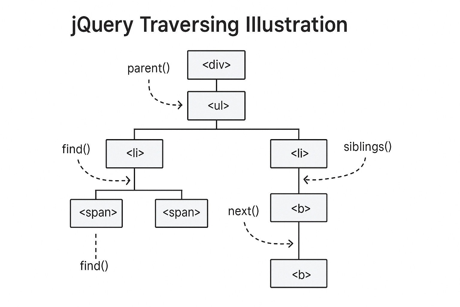

Explanation of the DOM Relationships:
  1. The <div> element is the parent of <ul>, and an ancestor of everything inside it:
  2. The <div> element contains the <ul> as its child.
  3. Every other element inside the <div>, including the <ul>, <li>, <span>, and <b>, are descendants of the <div>.
  4. The <ul> element is the parent of both <li> elements, and a child of <div>:
  5. The <ul> element directly holds two <li> elements as children.
  6. It is itself a child of <div>.
  7. The left <li> element is the parent of <span>, a child of <ul>, and a descendant of <div>:
  8. The left <li> element contains the <span> as its child.
  9. It is a child of the <ul>, which is in turn a descendant of the <div>.
  10. The <span> element is a child of the left <li> and a descendant of <ul> and <div>:
  11. The <span> element is inside the left <li>, making it a direct child of the <li>.
  12. It is also a descendant of both the <ul> and <div>.
  13. The two <li> elements are siblings (they share the same parent):
  14. Both <li> elements are direct children of the same <ul> element, making them siblings.
  15. The right <li> element is the parent of <b>, a child of <ul>, and a descendant of <div>:
  16. The right <li> element contains the <b> as its child.
  17. It is a child of the <ul>, which is in turn a descendant of the <div>.
  18. The <b> element is a child of the right <li> and a descendant of <ul> and <div>:
  19. The <b> element is inside the right <li>, making it a child of the right <li>.
  20. It is also a descendant of both the <ul> and <div>.
